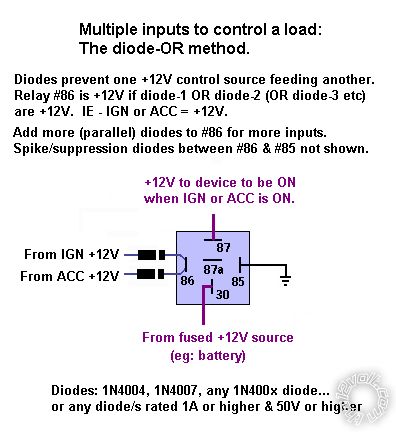

The wait was shorted than expected...
switched 12v distribution -- posted image.

Hey thanks a million! Just a few questions if you don't mind. For pole 30, would I need to install an inline fuse like a do a car stereo amplifier? What size fuse? For 87; I should be able to connect that to a fuse box that has multiple connections for accessories right?
oldspark
Gold - Posts: 4,913
Joined: November 03, 2008
Posted: April 19, 2011 at 11:49 AM / IP Logged
Yes....
You size the cable (30 & 87) to handle the maximum load current.
The #30 fuse is as near the battery +12V as possible/practicable and is sized to protect the wire or relay - whichever has the lowest current rating eg, if batt to #30 50A, relay is 30A, #87 to whatever is 40A, then fuse = 30A or less. (It can be eg 25A or 20A or 5A etc if that is still enough to handle the load.)
And yes - 87 can go to anything - an amp &/or other loads &/or a fuse box etc.
I assume your "fuse box that has multiple connections for accessories" is your own box & accessories. IE - you aren't cross connecting normal car accessories that should be off when cranking nor interconnecting IGN & ACC power.
Remember - a fuse protects the smallest thing DOWNSTREAM (cable, switch, relay) until the NEXT fuse which then protects its downstream stuff.
Equipment should have its own protective fuse, though there is no reason that any upstream fuse cannot be the same size... EG - a 20A amp could have a 20A (or 25A etc) battery fuse even if all upstream stuff handle 100A (100A cables & relay etc). Or is that too confusing? (It's just that if only using 20A through the circuit, why have an (expensive?) 100A or 80A fuse just because the cable etc is 100A. (It may be overrated to reduce voltage drops, or for FUTURE expansion which is when you would substitute appropriate fusing.
(But the battery fuse & cable & relay must handle to TOTAL load if multiple loads are fed.)

I understood you completely. For #86 on the relay, can this be fed with the remote wire from the head unit?
oldspark
Gold - Posts: 4,913
Posted: April 20, 2011 at 5:07 AM / IP Logged
The HU remote can feed it assuming it too is +12V (for on) and that it also goes through a diode if other inputs (#86 triggers) are connected.
