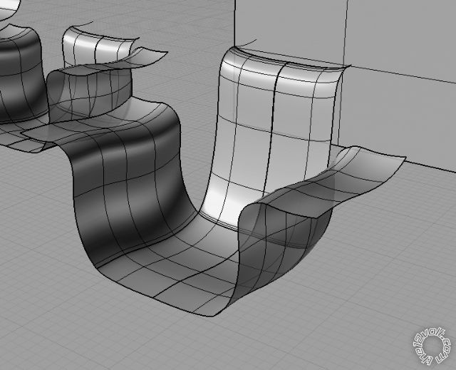

I'm trying to make this form-
fiberglass furniture? -- posted image.

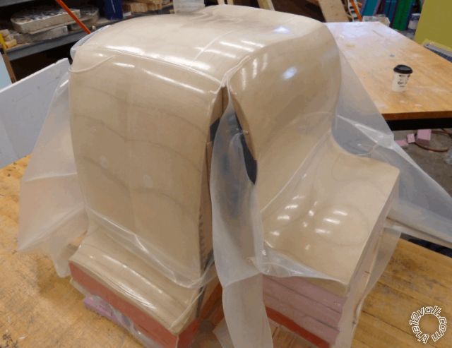

I have this mold which you can see here with a bag drawn over it-

For the first lay up i'm planning on:
-waxing down the mdf
-covering the mold with some drop cloth (polypropylene sheeting)
--post in progress--
carloed
Joined: April 23, 2011
Posted: April 23, 2011 at 6:47 PM / IP Logged
-coating 3 sheets of carbon fiber with resin and laying them over the mold one at a time
-covering the lay up with another sheet of drop cloth
-pulling the vacuum
does this sound about right?
