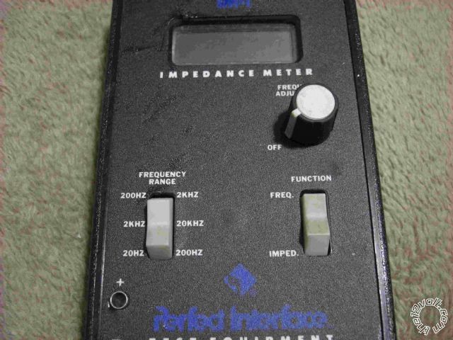

You cannot read voice coil impedance with an ohm meter.

then how you read it ?? i got a dmm
chris bringe
Platinum - Posts: 13,725
Posted: April 25, 2011 at 10:47 PM / IP Logged
keep blowing amp - Page 2 -- posted image.

Now THAT is cool!
