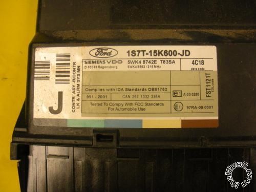

Here is a picture of the GEM module.
power locks lock but don't unlock -- posted image.
This location info from Audiovox:
KEYLESS ENTRY - LOCATED HIGH IN THE PASSENGERS KICK PANEL, BLACK COLORED MODULE, WITH 5 PLUGS IN IT
Posted: April 24, 2011 at 10:25 AM / IP Logged
You will have to change the whole box.
