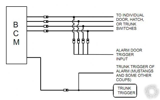

Why am I having such a brain lapse when it comes to diodes?? I have my 2001 F150 supercrew that I finally found the Doemlight supervison of BLACK/ lt blue, on the pass kick panel. This seems to be the easiest route for door triggers as, the domelight always comes on whenever any of the 4 doors gets opened. my questions is, how do I install the diode in this circuit? I am drawing a complete blank, does anyone have a diagram as to how it woudl actually "look"?

There you go...hope that it helps
diode confusion -- posted image.

Follow this
"The BLACK / YELLOW catches the drivers door and the BLACK/ pink catches the passengers door. The wires are found in their respective door harnesses. On the Super Crew the rear door trigger is BLACK/ lt. blue low in the driver kick panel. Use all wires and diode isolate each. See DirectFax document 1076 for wiring information. Both wires may also be found at the GEM module located above the fuse box. On models without a dome light delay use ORANGE / lt. green (-) at the light switch."
Follow the diagram above because you need to isolate the doors switches to make it work properly

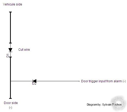

So for example, the dr door...blk / YELLOW, all I would do Is tap into that with the alarm trigger wire and insert the diode inline? Which way do I place the stripe end of the diode?
Thanks!

Do this and repeat for the other doors....

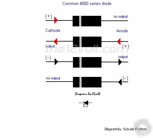

Diode explained.

Last thing...the band on the diode faces the door side correct?
