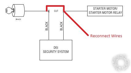

All, I am new to this.  I have the 300 Rattler and it was installed some years ago. I have lost the remote to the rattler and the battery had died thus now after getting a jump the alarm sounds.  Can you please give me advice on what to do. How do I easily disable because now my ignition or car will not start?  is it easy to get another remote or can I disable the alarm? I know where the rattler black box is but I dont know which wires to pull? Or do I need to pull any wires?

To get your car to start, you will have to reconnect the wires as in the image below.
300 rattler, how to disable? -- posted image.
I think you should be able to just disconnect all the connectors to the alarm module(black box) to stop the alarm from going off too.

Near the brain should be an inline fuse on the red constant power wire. remove the fuse and its disabled and the car will start.
Posted: May 21, 2011 at 12:04 AM / IP Logged
Or just pull the plug on the unit
