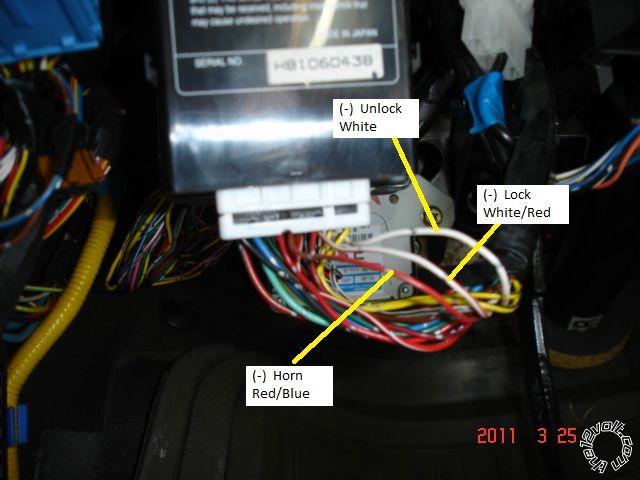

I am not familiar with the Nitro BMWX unit but it looks like you have built it relays for the door locks.  Follow their
wiring guide for Type B (-) door locks.  The Legacys lock wires are found in the module to the left of the steering
wheel. White is Unlock and WHITE/ Red is Lock.  Here is a picture :
nitro bmwx 433 alarm/starter on 99 legacy -- posted image.

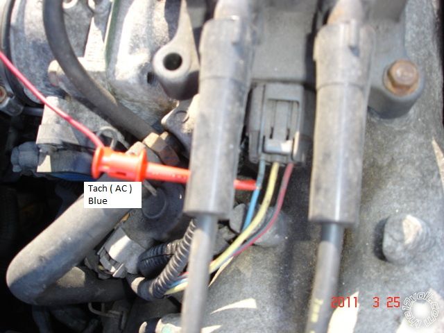

For the Tach wire, I usually get it at the coil pack although you can get it from the ECM behind the glove box.  Here
is a picture of the Tach wire at the coil pack  :
