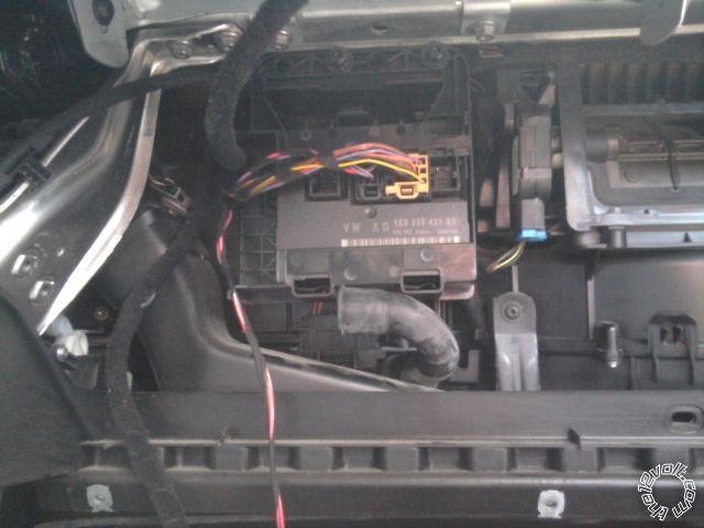

Also looking the ccm module behind the glovebox alarm for golf v2006 -- posted image.
guess isnt that the ccm ,right?

the lock working fine.even thre comfort function.the unlock domt working.but i noticed that with the keylock only drivers door is unlocking so maybe is vagcom set up.alao i upload a pic. Is behind. Glovebox.is this the ccm?
