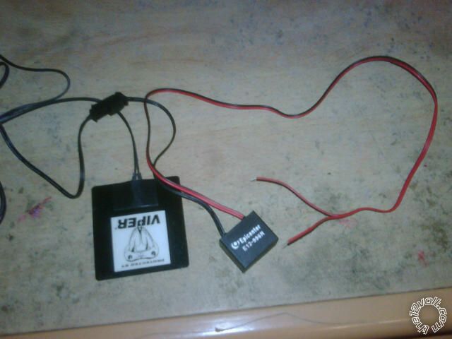

I want to install the 620v and it has 3 wire red to 12volts and orange to alarm. And black to ground but the black wire it as a plug on it and it has 2 black wire do I cut them? Help thanks.

Should be a clip in type plug, one red wire to 12 volts, and the black to Ground When Armed on the rs/alarm, ususally orange.

I really don't understand the first post. the 620v and it's variants consist of the flat panel, a black and a BLACK/ white wire. They go to a small black connection plug then to a small black cube. This has red and black wires, red to 12V+ constant and black to ground when armed. That's it.

620v viper electro luminescent indicator -- posted image.

Yet again, the red wire goes to a 12V+ constant, the red with a thin black trace goes to your alarm's GWA wire, orange on DEI product.

There's only 2 cables its orange and red with black!
So what do I do? Hey do I still have to ground it? Thanks sorry I'm giving you a hard time..
