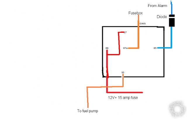

Posted: June 03, 2011 at 4:57 AM / IP Logged
Audiovox lists white + at the front fusebox so find your wire then if the alarm's trunk release is a low current e.g. under 300milliamps neg pulse, obtain a standard 5 pin Bosch automotive type relay* and wire as follows:-
Alarm's trunk release to 85
12V+ constant fused at 15 amps to 87 and 86
Cut the white wire, then fusebox end to 87a and
trunk end to 30.
Remember to also purchase a 1N4004 diode* and place in line to the relay with the band (cathode) away from the relay. See the diagram.
Sorry, ignore GWA on the diagram.

Posted: June 03, 2011 at 5:14 PM / IP Logged
Oh oh, we've got two different answers from Audiovox07 yaris trunk release -- posted image. Could I suggest our poster gets out the DMM?
