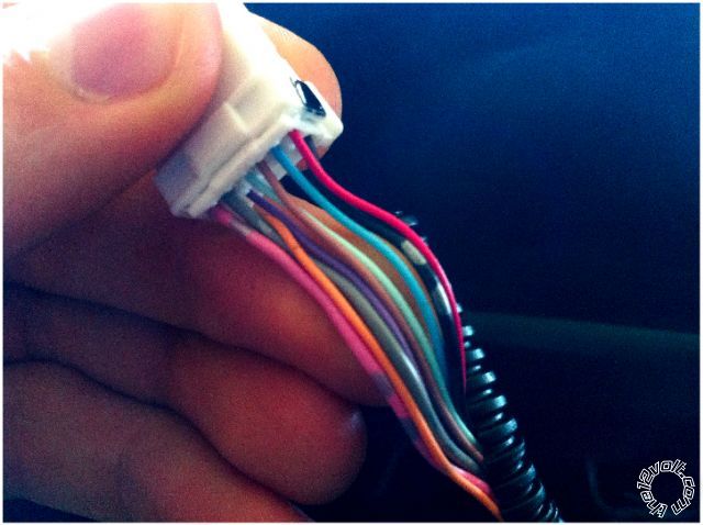

So I've opened up the dash and looked at the wires that I'm going to be connecting to. I've posted pictures below:
This is a picture of the wires leading to the signal indicator (which has the on/off switch for the headlights):

As you can see, the color options for the headlights are Red, BLACK/ Silver, Blue, Brown, Green, Purple, Gray/Silver, Orange, and Pink/Silver. Any idea which one is the headlights-lo beam? The gray, pink, and black wires appear to be a larger gauge than the rest, don't know if that has any effect on your analysis. Do you think the wires in the car correspond properly to the colors in the Nite Lite system?

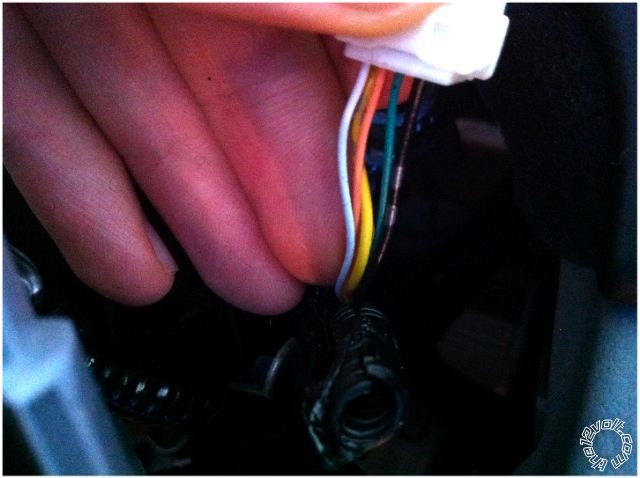

This is a picture of the wiring harness for the wipers:

The color options for this harness are BLACK/ silver, Green, Orange, Yellow/silver, and white.
I appreciate any insight you might have. Do you know if there is a diagram anywhere on the internet that can tell me what each of these wires do? (i.e., pink=right indicator, green=left indicator, etc. (obviously I don't know if that is really how the colors match up, I was just giving examples of what I'm looking for)). Thanks!
