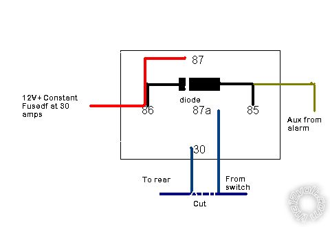

I have a 95 E 420 it has factory alarm so I got a Python 413 remote start .
I really would like to use the defogger but i cant seem to figure out how to hook it up.
The unit gives me a 200 mA neg output (latched / pulsed) .
The defogger has an ext combination relay.
But I drew a blank with this one. Any help would be great.
Thank you. e class rear defogger -- posted image.

Rear defog, best bet is to find the wire going to the rear window that goes to 12V+ when you turn on the defrost and wire it as follows:-

as always i thank you for your help    e class rear defogger -- posted image.
