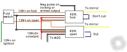

This is my trick, note how it's wired. Use the DEI 528t x2* I've wired it as fold on arm, unfold on ignition but you could make that unfold on unlock; or wire both triggers to the ignition, then auto fold in on switching off, auto fold out on switching on, cut the blue loop of the 528t on fold out. BAZ_mirror_fold.bmp

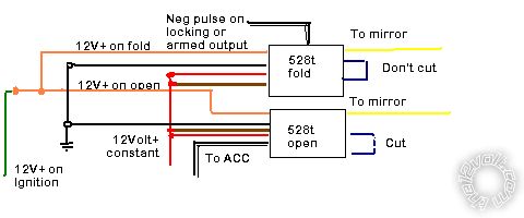

* Don't use normal relays, you will have a flat battery every morning.
with the 528t you set the internal timing for fold/unfold + 1 sec., job done.
