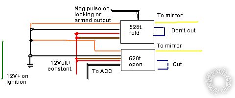

Your switch isn't compatible. Use the vehicle's lock and unlock wires in the driver's kick panel to trigger fold and unfold, or this method:- 754_mirror_fold.bmp

From the diagram, Two units of DEI 528t will be needed with each 528t handling the fold and unfold operation?
Negative pulse on locking or armed output, To ACC  <--> (< color=#231f20 size=1 face=Myriad-Roman>< color=#231f20 size=1 face=Myriad-Roman>< color=#231f20 size=1 face=Myriad-Roman>< color=#231f20 size=1>BLACK W/STRIPE - TRIGGER INPUT, DEI Manual)
To ACC  <--> (< color=#231f20 size=1 face=Myriad-Roman>< color=#231f20 size=1 face=Myriad-Roman>< color=#231f20 size=1 face=Myriad-Roman>BLACK W/STRIPE - TRIGGER INPUT, DEI Manual)
528t fold, don't cut <--> blue loop on the 528t (DEI Manual)
528t open, cut <--> blue loop on the 528t (DEI Manual)
Rest of color code corresponding accordingly
Reference the 754_mirror_fold.bmp diagram, How could I adapt it to work with the 1 push button that I have?
I am thinking both (BLACK W/STRIPE - TRIGGER INPUT) of the two 528t goes to the 1 push button?
thanks in advance for your help :)

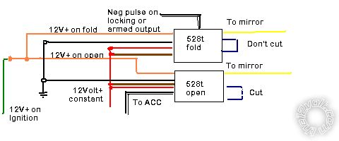

Yes but I've revised the diagram to give you automatic fold on lock and unfold with ACC or IGN 2*. See diagram:- 915_mirror_fold.bmp
Now the switch isn't needed. car side mirror retract with 1 button -- posted image.
* Ign 2 goes hot on key in ignition and dumps during the crank start cycle.
Time the 528t's for fold/unfold + 1 second.
Posted: July 10, 2011 at 5:16 AM / IP Logged
528t wiring both, brown and red to 12V+ constant, fused at 10amps.
Yellow to each direction motor wire.
Orange and black to ground.
Fold, BLACK/ white to door lock trigger, test, it's at the driver kick panel and goes to ground on key lock or keyless entry.
Unfold, BLACK/ white to ACC or IGN. 2. Cut blue loop.
Posted: July 10, 2011 at 5:18 AM / IP Logged
Power lock trigger should be blue/white in the driver kick-panel.
Posted: July 10, 2011 at 5:20 AM / IP Logged
Unless that switch gives out a negative pulse in either direction forget it.
You could use 3 terminals with a ground feed from a SPAL window switch, or a momentary push SPCO switch to control the fold.

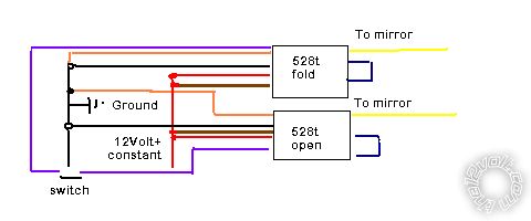

OK, now with switch, note don't cut blue on either 528t:-
