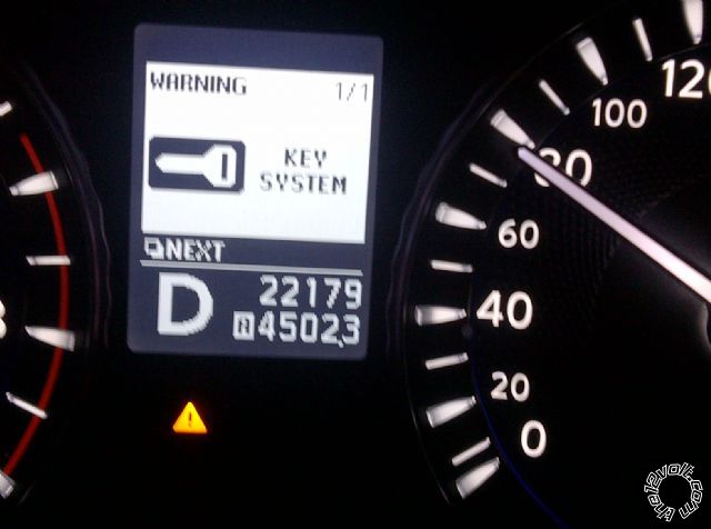

Hi all
Car: Infiniti M56 2011
remote start: compustar  FT-6200S-CONT
bypass: Datalink ads-al ca
the car will remote start without any problem but the issue when i enter my car and press the brake it shuts down and  the ignition turns to "On"... i press the button to get it back to off and start the car and this error comes to the  screen.remote start take over is not working -- posted image.
racing_bidule
Copper - Posts: 66
Joined: December 13, 2007
Location: Quebec, Canada
Posted: August 02, 2011 at 8:51 PM / IP Logged
Hi, this seems like you connected your (+) Brake pedal input from the compustar to the vehicle.
If you want the ADS module to handle take over for you, you must make sure you use Data brake pedal status not hardwired. Using data brake pedal status will delay the brake status output after the push button pulses are sent. Right now your remote starter receives the brake status before the pulses are sent.
If you fail on your first attempt, at least destroy all evidence you tried!
coco_ae
Member - Posts: 10
Joined: April 05, 2011
Posted: August 04, 2011 at 1:56 AM / IP Logged
i have connect the brake input to the ADS.
if i change to manuale take over whould it fix the issue for me?
and what about the error ? i'm afraid it will make an issue to to the system in the future.
