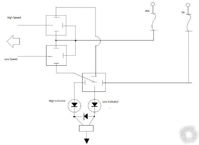

cooling fan relays /w indicators -- posted image.
Hey there, Kind of new to this and searched everywhere for help.
This is the new diagram I made to solve a problem. Aside from diodes across ther 85 & 86 terminals, do I need any resistors for this to work? The high speed setting will light both indicators.
The initial one I wired up burned out the diodes and now  every component connected to the same ground is not working. ( the alarm, tach guage, and illumination circuit) This is a kit car and every circuit was hand wired. Everything was working fine untill I added the indicators. I think the relay spiked my electrical system and there are no burnt fuses so I'm really agrivated... Aside from getting this to work I need to cross my fingers and hope that nothing is fried...
Any Ideas??

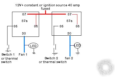

Far simpler than you think, use 12volt LEDs:- DZ3_fans.bmp

No point, I've already assumed in my diagram that you have a low current switch. Leave the LEDs where they are then you know the relays are working, if you place them where you suggest all you will know is that the switches are working, nothing else.
Diodes aren't needed across the relays in this set-up because all you have "in front" is a simple switch going to ground. Having said that if you must, 1N4004 across 85 and 86 with the bands towards 86.
Please note I also specified a 40 amp fuse or separate 30 amp fuses for each relay. Cooling fans can momentarily draw up to 60 amps each on start-up, i.e. onrush current.

Got it. Didn't think about that. I guess it's better to have the indication from the fan itself. I did add those diodes to the relays as well just for good measure. All is well, thanks.

There is nothing in the diagram to switch between high and low speed.
Posted: August 07, 2011 at 1:13 AM / IP Logged
I had separate switching Craig.
