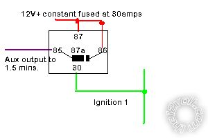

Do you have an aux output that you can program as a timed output for 1.5 minutes? And X 2 with Idiot and yet again with t&t, follow the rules and tell us what brand of alarm, now I see why you're a FORMER manager. Rookies would know better.will a 528t work for this application? -- posted image.

Posted: August 16, 2011 at 9:32 AM / IP Logged
Here's the diagram:- turbo_timer.bmp
Don't forget the diode, other wise you might well damage the alarm!
1N4004 either across 85 and 86 or in line (in series) with the aux, band towards the alarm.
Correct me if I'm wrong, but won't that require a push of the remote button to activate the timer? I would prefer to keep it automatically enabled if possible...

Posted: August 16, 2011 at 11:16 AM / IP Logged
Yes and it's the only way to do it.
