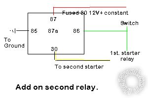

I need help installing a push button starter with relay. I have 2 starter input and need how to wire it for IGNITION SWITCH HARNESS 2 relay a diagram would help
12 VOLT CONSTANT WHITE (+)
STARTER BLACK/ WHITE (+)
STARTER 2 BLACK / YELLOW (+)
IGNITION 1 BLACK/ RED (+)
ACCESSORY /HEATER BLOWER 1 WHITE/ BLUE (+)
Posted: August 16, 2011 at 3:11 AM / IP Logged
Assuming the feed from the switch to the supplied relay is POS, (TEST) use this diagram, 2nd._relay.bmp
if it's NEG, let me know.

do you have a drawing of two relay. the one post is good.
thanks
Posted: August 17, 2011 at 1:08 AM / IP Logged
Post the original drawing especially the relay wiring please.

you need two relays.
If push button starter has two wires.
one side to ground-other wire to relay #85 (to relay 1 and 2)
86-30 to blk/red (ign) with 10amp. fuse
cut blk/white wire
87a to blk/white toward switch
87 to blk/white away from switch
second relay 86-30 blk/red (ign) 10amp. fuse
cut blk / YELLOW
87a blk / YELLOW toward switch
87 to blk / YELLOW away from switch
to start you car turn ign. on - and then push start button for 1 second.
