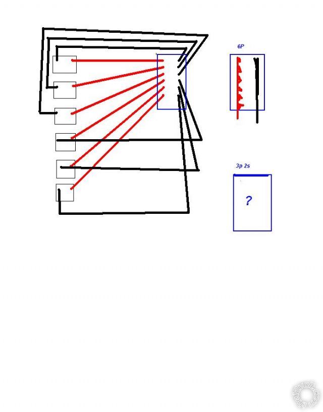

so.. nobody seems to have a practical opinion on my battery issue ?
I know I can undo the leads and reconnect all 6 cells in parallel to charge them, and then re-connect them in 3 x 2 series to give me my 24V LiPo charger power supply. but this is fraught with danger having so many leads floating about.. I can see a lot of sparking and wire melting happening in the process..
I was thinking maybe something like all twelve wires go to a home-made flat terminal block, each wire separate. A connecting plate could be applied across the 12 terminals which is configured for the 3p x 2s wiring. The connecting plate has the 24V output lugs.
Another different connecting plate could be applied that has the 6p wiring, with a 12V input lugs for charging ??
something like this rough pic I did in ms-paint ??
The blue plates A & B could clamp on to the temrinal plate to change the wiring config ? just not sure exactly how the 3p & 2S cpnfig should look ??

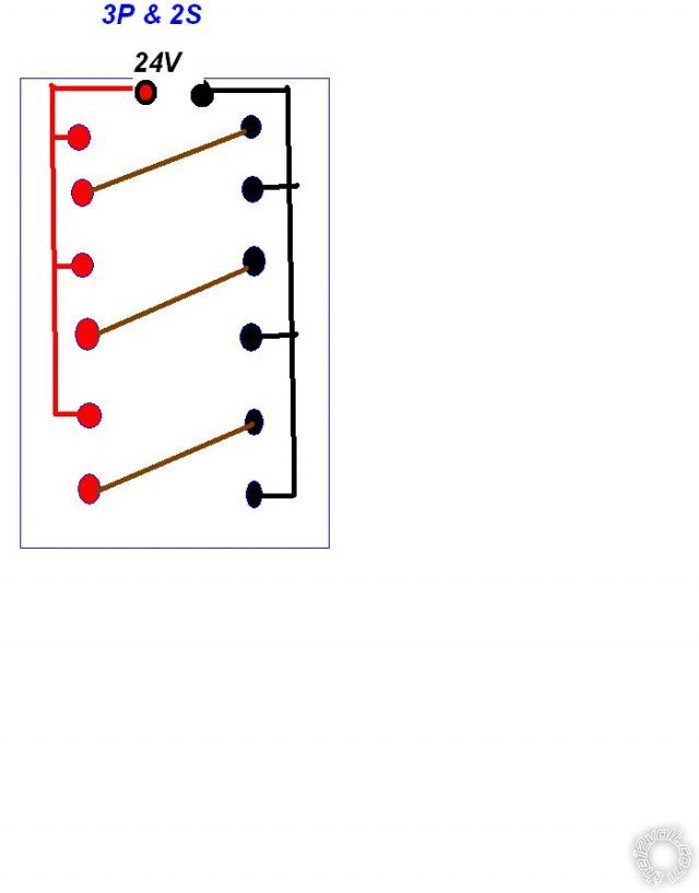

chanen1953
Joined: August 25, 2011
Posted: August 26, 2011 at 5:56 PM / IP Logged
ok... this would be the 3P& 2S wiring plate that should work..
anyone see any issues.. 24v supply from multiple 12v cells -- posted image.

There must be a way, though it's a matter of simplicity. 2 batteries is easy, but extending to 6...
Hang on, it should reduce to 2 batteries - ie, 2 lots of 3 batteries each with their +ve & -ve tied together - and then just interconnect them as if 2 batteries. [ How obvious! Why didn't I think of that before? ]

but now getting much too complicated.. especially when I want to revert to 6 x 12V wired in parallel for charging.. your solution now has a lot of components, and relays.. which add up to a significant cost..
I think I like my own manual wiring plate idea.. as the switchover between battery configurations does not need to be automated.. just a simple "unbolt a plate" and "bolt on a different one" when charging required. simple mechanics that cannot go wrong .. provided ti is made well.
