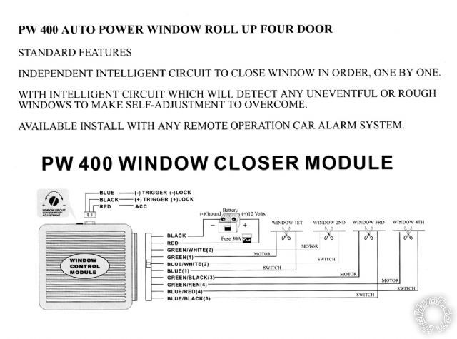

I have the viper 5901 installed, I did it myself with the remote start.
How do I go about installing this:
http://wolfcominnovations.com/images/vs/acc/pw400/pw400wiringdiagram.jpg

06 ram quad cab window module -- posted image.
