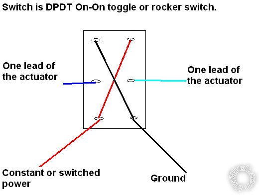

Platinum - Posts: 13,726
Posted: September 25, 2011 at 11:07 AM / IP Logged
linear actuator wiring? -- posted image.
Posted: September 25, 2011 at 11:48 AM / IP Logged
It is one touch.  Toggle or rock it up and it extends the actuator.  Toggle or rock it the other direction and it retracts the actuator.
Just incase he wanted simplicity and not have to deal with relays and such.
Posted: September 25, 2011 at 1:22 PM / IP Logged
He said the acuator has internal limit switches.  The switch in my diagram is an On-On, not momentary nor center off.  It will always have 12 volts across the actuator.  The limit switches internal of the actuator will break power  to the motor when it reaches end of stroke.
I guess the more accurate question would have been does your actuator have adjustable limit switches?

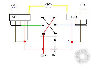

Posted: September 26, 2011 at 2:52 AM / IP Logged
One shot my way:- one_shot.bmp
You will need 2 x DEI 528t timer relays around $10 or less each.
First time how long it takes for the actuator to work both ways with it's load attached, then add 2 secs. to each direction. (Down might take less than up). Remember these times, e.g. 4 secs.
Bench wire the 528ts. Red to 12v+, black to 0v and BLACK/ white touch to ground. You can see the internal relay actuate. Set the timer pot to the nominal time, e.g. 4 secs.
Now wire exactly as per the diagram, cut the motor wires, green and blue and in each case join the switch side to the orange and BLACK/ white of the 528t.
Join the motor sides to the yellows.
Join the 528t browns to the reds and connect to your 12v+ source.
Joins the 528t blacks to your 0v source.
Cut both blue loops.
That should give you your one touch.
