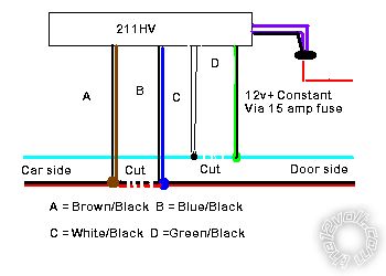

Help! Viper 211HV keyless entry is kicking my butt
Looking for a little guidance here; I'm trying to install the viper 211HV keyless entry in my '92 Chev 3/4 ton Ext Cab. So far, its not going too well.
What I've done so far:
I spliced my ORANGE / Blk hot wire with the Violet & Violet/Blk in the Viper harness.
- spliced the Light Bl with the WHITE/ Blk of the harness
- spliced the BLACK/ Rd with the BROWN / Blk of the harness
- spliced the Gray with the GREEN/ Blk of the harness
- spliced the Tan with the Blue/Blk of the harness.
- connected Red harness to chassis Hot
- connected Blk harness to chassis Ground
The way i currently have it wired, blew the 15A fuse on the Violet/Violet blk harness when i actuated the FOB. Also the passenger door switch doesn't work when I connect the harness to the Viper ECU.
Instructions from the kit are poor at best, there is a small note that states: "The system has door lock relays on-board, and can directly interface with most electric power door lock systems drawing 30 amps or less".
Do i still need Relays to make this kit work? If so, how should it be wired given the layout of this kit?
Below is wiring guide provided by the Viper 211HV:

Assuming light blue is lock wire and BLACK/ red unlock and in each case they are at rest at 0v, i.e. ground, when you lock does the following happen? Light blue shows 12v+ and BLACK/ red stays at ground.
When you unlock vice versa?
If so wire as follows:-
axle
Joined: September 27, 2011
Posted: September 28, 2011 at 9:04 AM / IP Logged
Yes, that is what I determined. Light blue and BLACK/ red are normally at rest, then provide 12volts when I activate my switch. (Lock) light blue, (unlock) BLACK/ red.
I will go and do
Posted: September 28, 2011 at 9:38 AM / IP Logged
Then that diagram I posted is correct.

Okay, thanx for the diagram. I need to make a slight modification I believe since for my truck, the driver's switch controls the passenger switch and the passenger switch controls the motors. So from driver door light blue to WHITE/ black then GREEN/ black to other end of light blue. Then, RED / black from driver door to BROWN / black and blue/black to other end of RED / black. Does this make sense to you?

Yup, that did it. System works as advertised now! Thanx for the help. BTW where did u get the diagram.

Actually, it isn't a joke at all, consider:-
N/Closed = 87a = to the control unit
Normally open = 87 = 12v+ constant
Common = to the doors.

Well, for me the confusing part was the lock/unlock #30 output. I expected this was somehow tying into the motors since it was the #30...I thought those relay pins normally associated with the higher amperage draws of the motor.
