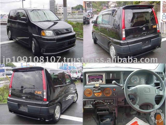

Hi,
Can someone provide me the Vehicle Wiring Information for 1997 Honda S-MX as I wanted to install car alarm in it.
Thanks

Do you have any idea of that vehicles name here in the states?

Sorry I do not know whats it called in States.alarm wiring, 97 honda s-mx -- posted image.

I do not think I have ever seen one of those over here.  Give me a minute.
