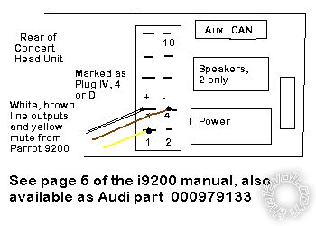

Or of course just obtain the radio pin outs and use the Parrot's low level outputs, speaker +, - and mute to input the radio directly.
If you speak to Armour Auto or Parrot's tech boys, there is a plug to fit into the back of the Audi head unit that will do it probably 06-088B

No it's automatic! Not installed correctly.
Mute signal from the Parrot will switch the head unit inputs automatically. You might even be able to buy that kit from an Audi dealer (at what price?).
Don't go for a clever remedy, keep it simple and make those phone calls tomorrow.
If you look at the rear of the Audi head unit you will either have a row on top of the 2 x ISO plugs, or down the centre. Fully loaded that slot has green, yellow and blue plugs in it. The green is the one, yellow for amp and blue for factory CD changer.
Posted: October 02, 2011 at 3:13 AM / IP Logged
This is the correct pin configuration, it will save you from having to push buttons on phone calls. Connecting the mute SHOULD pause the CD transport but I can't guarantee it, we have Grundig (now out of business) connecting to Alpine via a third party (PAC? although Mr. I knows better than me), none of the above parties will help you.
I can't because I have Alpine HU and changer, which DOES pause during phone calls + auto answer on my Parrot (in the settings menu), so nothing is touched!
Yes I'm a pro as is Mr.I, he more on the electronic side, me installation which surely is why you posted here in the first place.
Sorry for sounding patronising but KISS is the first rule:- concert.bmp
