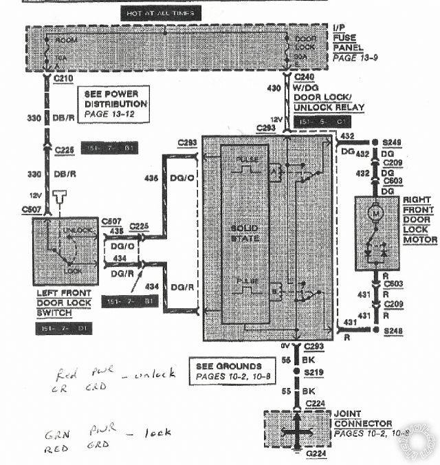

I have a 91 Escort GT that I added factory power door locks to. I am installing a remote start system that has security and door lock features. Im not wiring any of the security (why bother on a 91 Escort? LOL) but I want to use the keyless entry function. I have added a lock actuator to the drivers door as this unique low end factory system does not originally use one. I cannot find any door lock wiring that matches this system as it different. It does not use a keyless remote or even a switch inside the car. When you lift up on the lock knob or turn the key in the door lock it throws a switch to either LOCK or UNLOCK depending on what you are doing. This send current to either the LOCK wire or the UNLOCK wire which in turn goes to a solid state relay that sends a single short pulse to the door lock actuator to either lock or unlock. So one of the wires always has current to it but the solid state relay only outputs that short pulse and then thats it. My remote start kit puts out a negative signal for lock or unlock. I just cant figure out the proper way to wire relays into this system. I really dont want to get into using diodes if I dont have to as I never did that. I think the lock actuators just get the power and ground reversed for lock or unlock. But if I have the relays send power to the output side of the solid state relay Im afraid it would back feed into the relay and mess it up. Can anyone give me some insight and tell me how to correctly wire this setup so I can use the keyless entry feature? Am I correct in assuming that I dont need to wire the starter kill relay as well as it is for the security system which Im not using?

The actuator is only 2 wires. This is a different system than most Im sure. As I said, its a low end power door lock system originally. It only uses a RH actuator as you are manually unlocking the drivers door with either the key or if you are inside you are pulling up on the door lock knob. Either of these actions causes the power to either the LOCK or UNLOCK input of the solid state relay and it sends power to the RH actuator. You can easily tandem in a LH actuator as I have done which serves absolutley no purpose unless you have a keyless remote system added on. There is no actual switch in the doors to lock or unlock. need advice on power door lock wiring -- posted image.
This is the wiring schematic. The switch in the LH door latch sends constant power to either the LOCK or UNLOCK input of the solid state relay which gives a pulse to either the lock circuit or unlock circuit. Simple enough but just dont know how to tie into that with this system so it doesnt backfeed into the relay and mess something up.

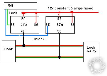

Use this method, requires two relays:-

But wouldnt this method backfeed into the solid state relay and possibly cause damage? I just want to make sure Im not gonna burn something out.
Posted: October 14, 2011 at 1:34 PM / IP Logged

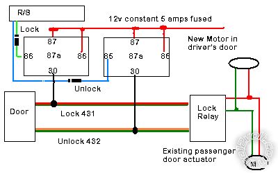

No, not at all but to protect your R/S place two diodes inline on the lock wires from the R/S to the relays, also an actuator in the driver's door can be paralleled off the existing motor wires to give you full locking. This system is identical to Volvos an others in the late 80s.
See diagram:- 21B_ford.bmp
Just to be difficult, wire your locks to relays to add motor, see the relay diagrams on this site and simply add one actuator to the driver's door, this should have the effect of locking and unlocking the other door if the lock button already does so, trouble is it's six of one and a half dozen of the other, same parts etc.
