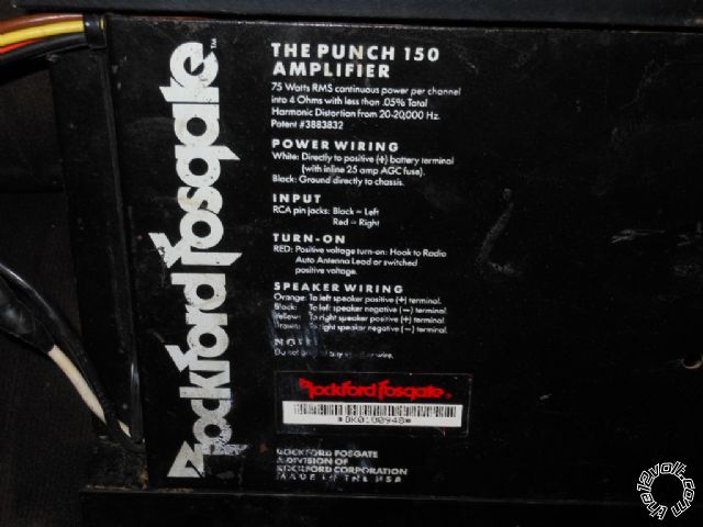

itsyuk
Silver - Posts: 505
Joined: February 23, 2010
Posted: March 05, 2012 at 4:42 AM / IP Logged
what i always loved about those amps was the bass center frequency was something like 50hz and the treble was centered on 15khz.
here is pic on the non HD punch 150 i just took out of a boat back in september. used it 15 years in the boat and still works perfect.
sold the boat.
 rockford fosgate punch 150 hd - Page 3 -- posted image.
yuk
quiet rural missouri, near KC.
If your system moves you physically and not emotionally, you have wasted your money.
Platinum - Posts: 13,726
Posted: March 05, 2012 at 9:50 PM / IP Logged
That is not an HD amp, that is the revision just before the HD came out.  That revision is the one to have.  It had a much more reliable power supply than the earlier revisions, and was MUCH better than the HD line.
