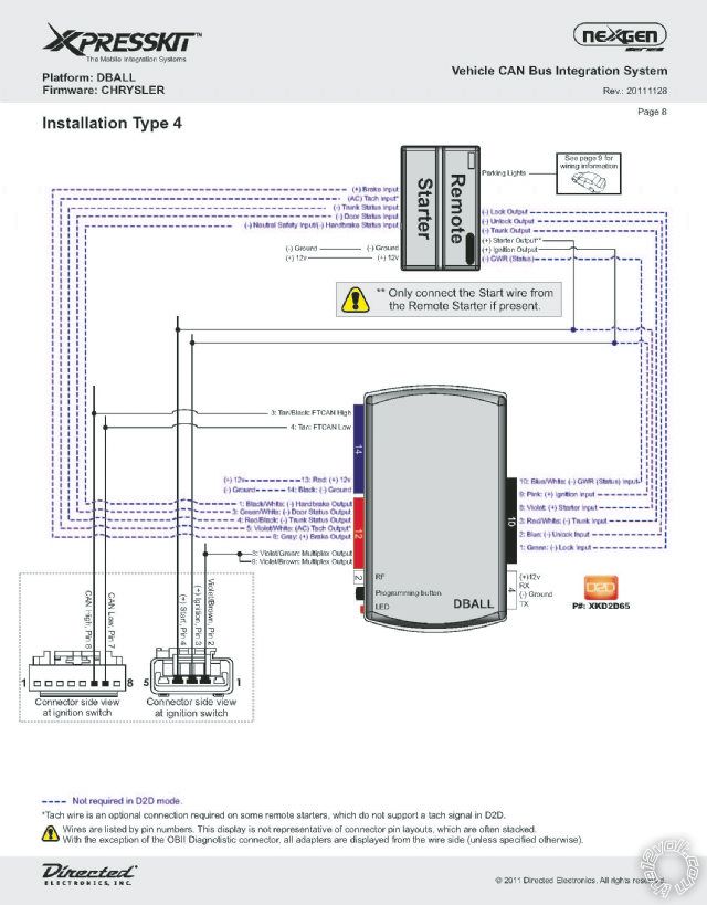

Btw, last night I removed the relay setup I had, reattached the PURPLE / brown wire I had cut per 1084, reset the dball (not reflashed), and no go. Just to make sure I have the right heavy gauge wires connected... I have the H3/1-pink to pink/lt green @ ign hrn; and H3/4-violet to pink/orange @ ign hrn, and that is all, aside from the 12v to all fused inputs on H3 harness. And this is the dball diagram I have been using:

dasbogie
Silver - Posts: 514
Joined: September 30, 2006
Posted: July 01, 2012 at 9:39 AM / IP Logged
whenever you send the command to remote start, does the viper or vehicle respond at all?  Does it flash the vehicle parking lights 7 times?  Does the ignition turn on?  Does it try to crank?  Do you get any lights on the dball?
