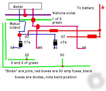

OK, the first diagram tells me what I knew earlier, the ignition shouldn't light up in the ACC position.
Here's how the wiring goes:-
2 reds and RED / white, join one of them to each red.
Cut BLACK/ brown.
Green to key side and violet (purple) to starter side.
Pink to ONE of the greens (any one)*
Pink/white to violet.
Orange don't use.
*If the above doesn't work, follow this diagram:-
Sorry about the scratchy lines, new mouse!
I would have thought you could join to 1 of the light greens but that first diagram of yours proves me wrong.
I wonder if you meter across them with the ignition off they are continuous, if so you won't need my diagram with 2 extra relays, 2 diodes (1n4004) and 2 30 amp fuse holders.
