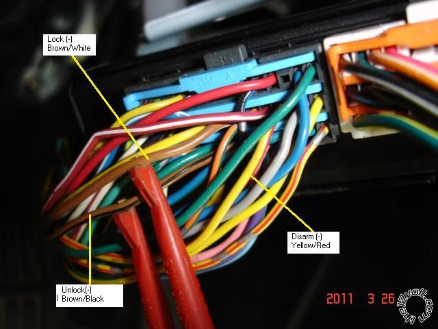

Here is a picture of the BIU with the wires marked  :
05 outback factory alarm wiring -- posted image.
This picture is from a 2006 Outback and a standard (-) 200mA disarm pulse straight from the R/S brain worked fine.

Thanks for the reply. Those are the wires I used for lock and unlock. They are N/O until the looks trigger with a - pulse. Worked fine straight off the RS.
The yellow/red is the one that shows N/C hot until the door key cylinder unlocks which opens the circuit.
I feel like putting the RS -200MA trigger to this constant hot wire is a No No.
