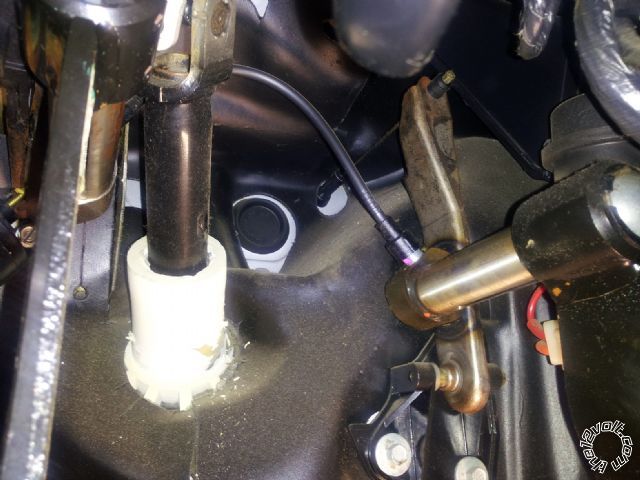

above the gas pedal, big holeplug/grommet...two inch hole?

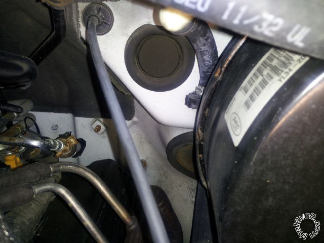

So I happen to have a 2003 F150 come in for a remote start...and I figured since pictures make everything easier...here you go.
Under the dash

Under the hood

Awesome pics, Twelvoltz  Thanks so much for the help and replies
