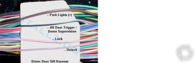

Here is a picture of some hard to find wires :
2006 f 150 remote starter -- posted image.
