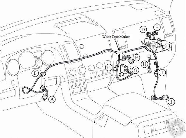

In the dBALL manual it says you might have to pyscially diable the remote starter to proceed.  IF SO, DOES ANYBODY KNOW WHERE THE FACTORY REMOTE STARTER MODULE IS?  How do you disable it?

there is 8 more comprehensive photos. but i am at work if you need the other photos PM me and i can email you.
2011 lexus gx 460 adding remote starter -- posted image.
