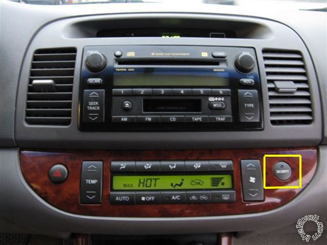

I just did a 2003 Camry 4 Cylinder, and it had no transponder. Its easy to see if it has one, there would be a "security" light on the same panel as the heating controls. It would be on that panel to the right. Usually only the 6 cylinder motors, or the XLE trim have a transponder. If the security light isn't there, then there is no transponder. Here is a picture of the security light, it would be in the same location for digital heating controls or manual.
prestige aps901c remote starter -- posted image.
