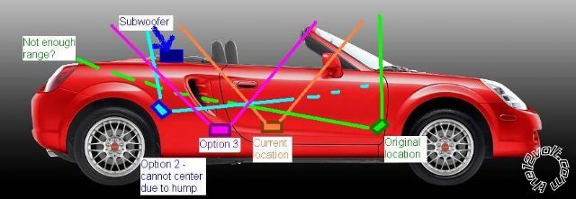

Started getting false warnings from the sensor. Turns out I was supposed to have this rotated 90 degrees? It's not as convenient to mount that way, but it does seem to be working better.
However, I don't feel like the sensor is working well in the back of the car, where my subwoofer / storage is located (even though it's probably better than before).
I don't want to increase the strength because it'll pick up past the sides of the car. Instead, I'm thinking about relocating the sensor again.
Thoughts?
got a 50.7x for my '05 mr2 for xmas - Page 2 -- posted image.
Posted: January 19, 2012 at 11:38 PM / IP Logged
Try to understand that this is suck and see, you have to play with it to get it right.
