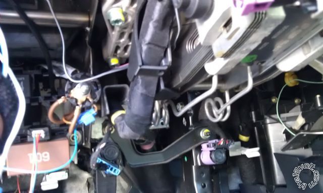

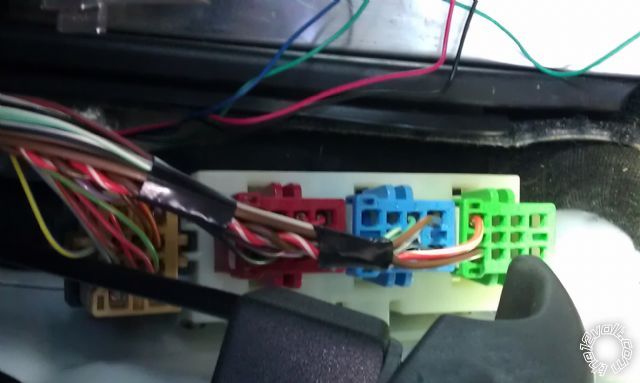

I have an Audi TT 2003 Coupe 8N. I bought a DBall unit because it said it was compatible on Xpresskit.com. The supplied installation manual is incorrect. There are no brackets in the location given for my vehicle nor can I find any wires colored ORANGE / Green. I have checked all other installs for Audi listed by DEI's manual and none work. I am not sure which wires are the CAN wires on my car although I found a twisted pair near the firewall which are colors ORANGE / brown and ORANGE / black. I have tried to connect the DBall CAN wires to this to no avail. Questions: Are these the correct CAN wires? If not is there any other access point for these wires, and what are the colors? Could their software flash be incorrect? Has anyone gotten a DBall unit to work with an Audi TT 2003 or any Audi of that year? PLEASE HELP!!!!!!!!!!!!!!!!!!!!!

First off, do you have the right firmware on the DB-ALL? It should be loaded with 401.VWAUDI v1.05. I think you have the wrong install manual for the DB-ALL. Go onto xpresskit.com, enter your vehicle information, then under the db-all option it will give you a link to download the install manual as a PDF. Then figure out which install type you need (should be type 5). I am showing the Can high as being Pin 9 on a brown 23 pin plug by the steering column it will be either Violet/white, ORANGE / Green, or YELLOW /GREEN. Can Low is Pin 6 in the same plug; either Violet, ORANGE / Brown, or Yellow/Brown.

Thank you for the reply. It is the correct firmware, and I retrieved all of the information from their website. The harness it shows in their website does not exist. I pulled every bit of information I could of Xpresskit's website, and to no avail. I have researched extensively on the internet and I am beginning to believe that they made an error when writing the installation information for the 2003 Audi TT Coupe. I have actually tried after flashing it and then reflashed again with xpresses program to make sure there were no possibilities of error. Please help.

Do you see other items in the picture? It appears to be under the steering column, but the general area reference could be incorrect. Do you see that rounded spring looking bracket on the steering column? If you could take a picture of your car oriented similar to the picture in the install manual and post it up here it may help...

dei python -- posted image.
kick panel

Howie, Thank You, you saved me some time with customer service. I already have the key bypass and it is installed correctly (already tested). The only thing I want is the Python 574 to interface with the factory alarm via D2D using DB-All. I am not trying to place blame on anyone, but the installation guide for the correct CAN bus wires is incorrect as you can see in the picture. I can wire the Python 574 into the alarm directly, but I don't want to feel like I wasted the money on a DB-all module. If I could find the correct CAN wires I would gladly install the module. I have tested the ORANGE / Brown & ORANGE / Black twisted pair  at the firewall as well as the Brown @ RED / White twisted pair in the kick panel and the only wires I received a response from is the radio location ORANGE / Purple, and ORANGE / Brown wires. The latest update on their AUDI VIN program was this year so I would think that they would have the correct flash for a 2003 model Audi 8N vin number as listed in their compatibility chart. If you could tell me the location or even the color of the correct wires it would be greatly appreciated. I have searched for a pair of every color listed on Xpresskits Installation guide and have found none including no ORANGE / Green wire what so ever. I have searched the radio, under the dash, in the engine, the central locking module, the glove box, and the ecu. I know a location for the CAN wire access at the ECU bracket, but I would think that there would be some kind of access to the CAN wires from some other location. PLEASE HELP!!!
