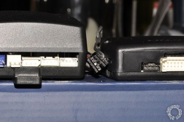

One followup question having to do with the data link cable supplied by Fortin. It doesn't fit into the connector on the U1280.
My Ultra Start connector layout is new and shown here http://ultrastarters.com/manuals_download_pdf/2011%20manuals/80_newboards.pdf. I verified with support@ultrastarters.com that the diagram is correct.
I'm guessing the U1280 connector is for an iDataLink and that the iDataLink and Fortin connectors are different. If that's correct, what's the correct way to make the connection? Is there an adapter available? Neither the U1280 nor the EVO-ALL supplied a male connector that will fit into the data port on the U1280.
Here's a pic of both modules and the Fortin-supplied cable.
evo all, ultra start u1280 -- posted image.
Coincidentally, the cable fits perfectly into the far-right connector on the U1280 :(
Thanks again,
Jim

Think all you have to do is trim the raised edges of the supplied connector flush with the rest of the plug such that it fits into the slot. The rest of the plug dimensions should be OK.
jimse
Joined: December 28, 2011
Posted: December 30, 2011 at 2:53 PM / IP Logged
Trimmed the connector and squished it in there. Everything went together with zero problems. Wife is super happy.
Thanks again for all your help!
