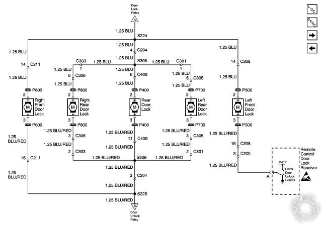

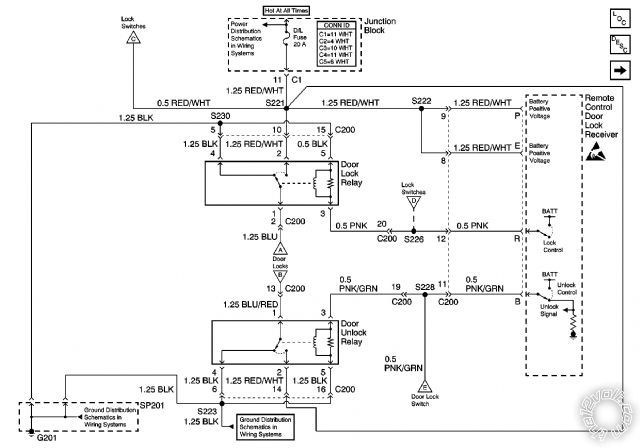

here are the schems for the relays from the GM dvd
1999 chevy tracker door lock type -- posted image.

here is the servo schem.

Posted: December 31, 2011 at 12:44 AM / IP Logged
itsyuk, surely that scheme is for vehicles with existing keyless? In which case our poster's answer would be pink lock and pink/green unlock, POS going.

It doesn't have a factory keyless entry system, just power locks. I'm new at this and was wondering how to wire it. Not sure if I'm going to need relays, or how to wire those if I do.

the schematics i posted are the ONLY schematics for that vehicle from the actual GM service disc.
the relays are above the accelerator pedal.

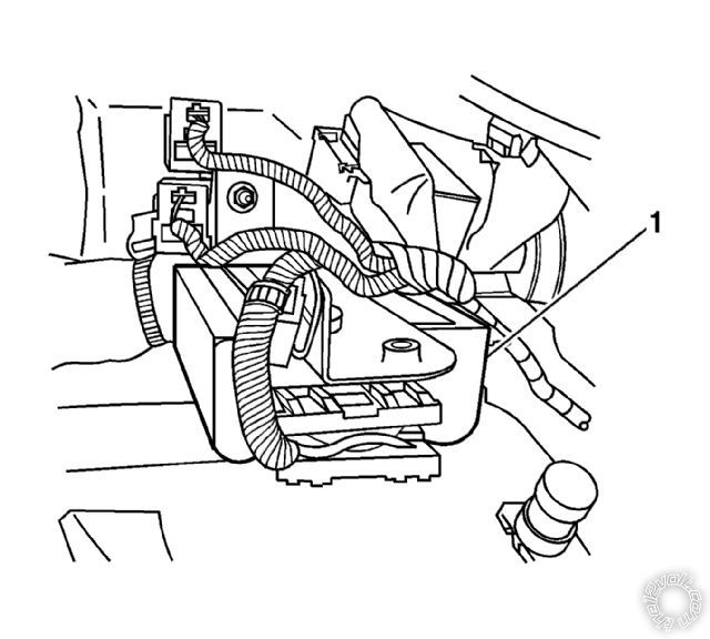

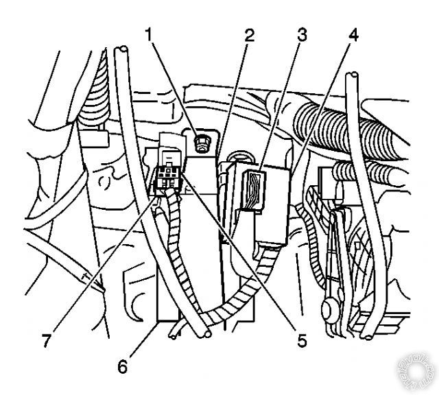

is there a chance you are not the original owner and it had RKE and you just dont have remotes for it?
RKE reciever is near the column on the firewall.
here is a looking up view of it and a view like if the dash was gone.

Posted: December 31, 2011 at 12:15 PM / IP Logged
here is the dash removed view
