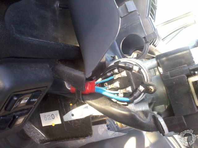

hi happy new year,for all,guys need a wiring diagram for remote starter on this work truck please asap, i will try to put a remote starter on this truck ,i dont have any idea if it works  or not ,i will be happy if you guys can help me out here thanks again

Verify with DMM.  2006 chevrolet w 3500 box truck -- posted image.

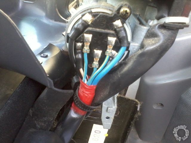

thanks kreg this is what i have test WHITE/ black power 12v ,BLACK/ white start, blue ign , BLACK / YELLOW acc the others 3 wires i dont know how to get it connected to a bypass and with one to use blue/white,blue,blue / YELLOW2006 chevrolet w 3500 box truck -- posted image.

sorry i up load  both same pic now im up load the other one sorry2006 chevrolet w 3500 box truck -- posted image.

hello everyone , please need to figure out it ,if this truck has any kind of theft ,i know  for sure it  will not  start ,just crank ,crank that's all,so i have 3 wires ,blue/white,blue,blu / YELLOW, probaly its a some kind of passlock??? just dont know with bypass to use on it  please some help here ASAP  thanks
