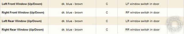

Hello All,
New to the site and I would like to know if anyone out there has experienced a problem installing the Directed 530T for the H2 Hummer. I have a 2006 model H2 and currently I have installed the Viper 5901. It works flawlessly but I cannot find out what wires to tap into so I can connect two 530T's for roll-up/roll-down of my 4 door windows. I have tried to tap the wires in the front drivers door and I can't get a trigger that works for either door right now. I am trying to avoid running 2 or 4 wires directly from the doors, up to the front drivers door where I will have both 530T's located.
Please let me know if you have a workable solution, schematic or whatever has worked for you. Looking forward to great replies......

AUDIOVOX
     LF Window Up          DARK BLUE          (REV)          AT MOTOR IN DOOR
     LF Window Dn          BROWN          (REV)          AT MOTOR IN DOOR
     RF Window Up          DARK BLUE          (REV)          AT MOTOR IN DOOR
     RF Window Dn          BROWN          (REV)          AT MOTOR IN DOOR
     LR Window Up          DARK BLUE          (REV)          AT MOTOR IN DOOR
     LR Window Dn          BROWN          (REV)          AT MOTOR IN DOOR
     RR Window Up          DARK BLUE          (REV)          AT MOTOR IN DOOR
     RR Window Dn          BROWN          (REV)          AT MOTOR IN DOOR
     Sunroof Open          BROWN          (+)          SUNROOF CONTROL SWITCH
     Sunroof Close          ORANGE          (+)          SUNROOF CONTROL SWITCH

In a nutshell you use the orange GWA wire on the R/S to the orange on each 530 and an aux to the RED / white.
Make sure the grounds go back to the vehicle body and feed the closers via either one or two heavier gauge wires directly from the battery, each fused at 30 amps at the battery.
Ground, either at existing ground point in the vehicle or at the battery.
Make your connections in EACH door between the switch and each motor.
This is according to the instruction manual a type "A" or type "1" layout, i.e. switched negative at rest.

Yes, I know it's a right PITA but there are two reasons.
A lot of Japanese and European vehicles use a data signal from the driver's door to processors in the other doors, "strange wiring" at each switch and no motor wires in the driver door entry cable at the driver's kick panel to connect to.
Secondly to ensure "one-shot" operation at all switches it's essential to wire between the "last" switch and the actual motor.
Also this keeps the 530t in the vehicle rather in the door where it's better protected against the elements.

2 x 12 (motor side) and 2 x 18 or 20 (switch side) for each door.

No it won't DEI actually mention going straight to the motors if you want to retain one-shot at all the switches, has he ever read the install manual?
