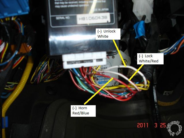

Are talking about this door lock module?
door locks on 98 legacy outback -- posted image.

OK, sounds like an aftermarket unit.  I've only done a few of these Outbacks ( 1997 - 1999 ) and all have had this style Factory unit shown in the photo.

I just went through this also. The person bought this car used and the drivers door actuator wasn't working. I think it has to do with the factory keyless. The factory keyless according to the internet had drivers door priority unlocking. I believe the factory unit must have had the relay for drivers door priority built into it. When it is unplugged and removed you loose your unlock motor wire. What i did to fix this car was i jumped a wire from the unlock motor wire located in that picture above(though the doorlock module in the 98 i was working on had alot less wires). I tested for a wire that went positive when I hit unlock and sat at ground when nothing was pressed. That wire jumped into the drivers kick panel. In the kick panel there is a hole with alot of harnesses tucked into it. There was a 2 pin harness, Those are your motor wires. One is your lock the other is your unlock. I tested to see which one was the lock wire by pressing lock and testing for positive. The other was the unlock wire. I sniped it and added my jumper wire to the wire going out to the door. Presto, the doorlocks worked. Of course I had the door panel off also. That helped me to find the 2 pin plug in the kick panel because I already saw the actuators motor wire colors in the door.

oh and the factory door lock module is to the left of the steering wheel facing you, plug facing the floor. You can't miss it. It has your white and WHITE/ red negative doorlock wires from the door panel switches.
