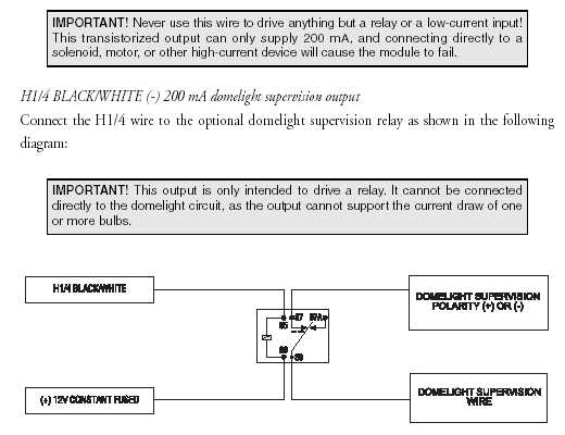

Can someone help me figure out where the Domelight supervison wire is and how to hookup this relay.  I have found the (+) 12v white wire, which I believe is to be the domelight supervison polarity wire (+) input but where is the Domelight supervison wire?  Do you tie these wires together? Are they the same wire?  if not where is the domelight supervision wire ?  I have looked at several schematics , nothing listing a supervison wire and a (+) polarity supervison wire. I have a 98 pontiac sunfire.  with a DEI python 460hP alarm.  Help is greatly appreciated!
DEI relay question -- posted image.

Ok here is what you need to do. First find the drivers side door trigger, it should be GREEN/ black in the dside kick panel. Then wire a relay: 85 12V+, 86 BLACK/ white supervision output, 30 ground, 87 output to door trigger. It is important that you use the actual door trigger and not the wire going to the light.
