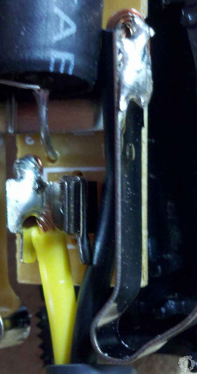

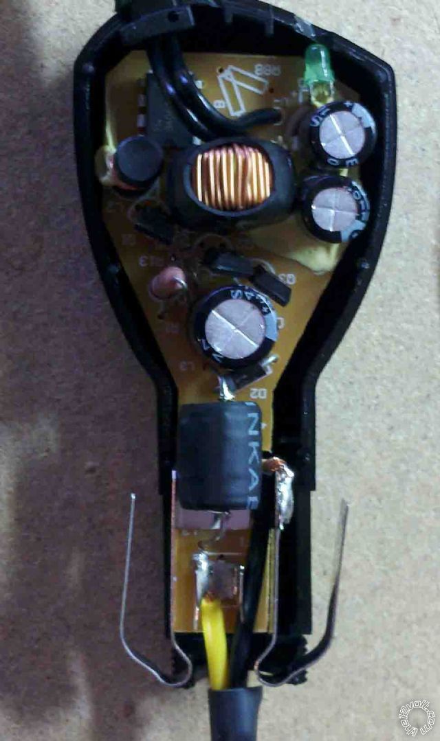

I got it to work I attached pictures to show where the wires were sodded. The Yellow is the positive, the black is the ground/negative. Works with any positive/negative wires.

If you want the better quality pictures just PM me and I can send them your way. Enjoy!

You eliminated the fuse.  Make sure you fuse the device externally.

Not pictured, is a fuse added to the line between that and the power supply.
