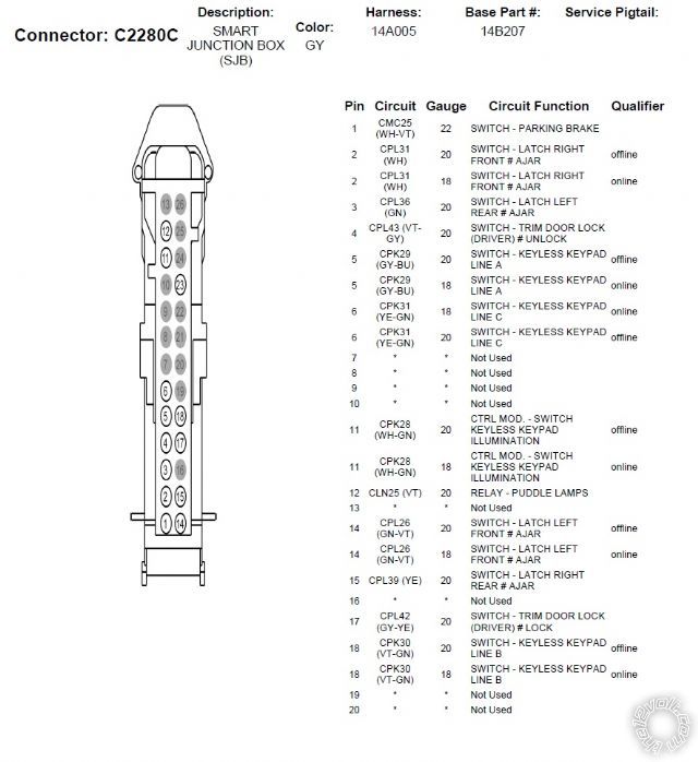

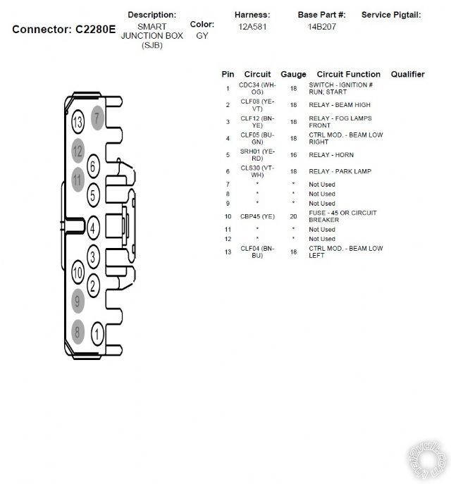

danmc85
Member - Posts: 44
Joined: January 03, 2012
Posted: January 25, 2012 at 9:05 PM / IP Logged
Try grabbing everything at the smart junction box, I am not sure where it is located exactly in a F150. I know my ford escape SJB is in the right center console near the fuse box. I had to take my center console apart to get at it.
Anyways here is for your truck, but test all wiring.
Parking Lights On: (Violet/White) SJB C2280E Connector, PIN 6 (+)
Door Lock (Gray / YELLOW) SJB C2280C Connector PIN 17 (-)
Door Unlock (Violet/Gray) SJB C2280C Connector PIN 4 (-)
Ford also had a note that the Parking Lights On wire color can vary on some F150's however they stated it is always on SJB Connector C2280E, Pin 6.

danmc85
Member - Posts: 44
Posted: January 25, 2012 at 9:12 PM / IP Logged
2010 ford f 150 remote starter -- posted image.
