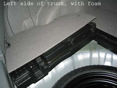

Ludecrous
Member - Posts: 13
Joined: May 01, 2003
Posted: May 02, 2003 at 12:23 PM / IP Logged
Here is a picture, this is to the left hand side of the trunk, you can see the foam (black color)

I just measured the foam, it's 4.5" thick, can I still drill through this to mount the basslink ? are there any other options?

Do you plan on opening the hatch after the basslink is installed? That foam is normally pretty dense and can be used as an anchor. I would try and mount the basslink with 2" or so screws and see what happens. But either way let me know if you want that hatch to open and I will try and assist you in making this all work

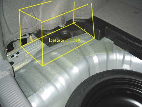

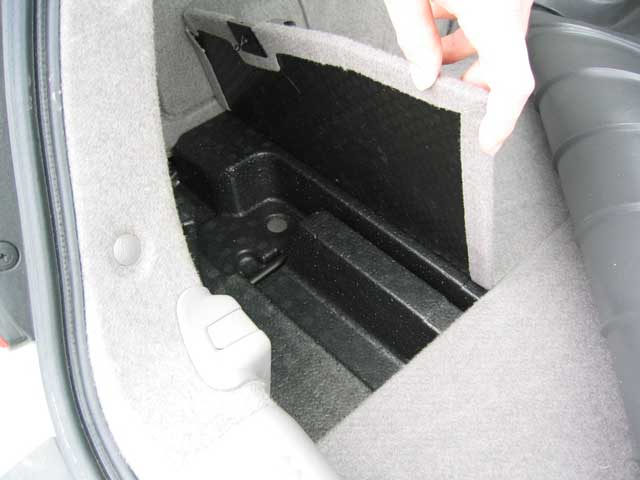

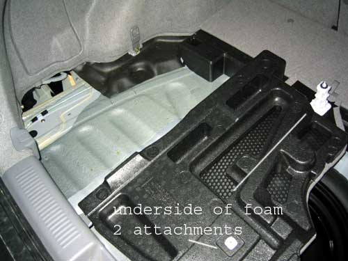

I have been doing a lot of thinking and I pulled the trunk of my subaru wagon apart to see what was there.
I will be opening the hatch in normal use of the car after I have installed the basslink, at some point I may also want to temporarily remove the basslink (depending on mounting location) to utilize all the space
It seems like I have 3 options to mount the sub, I don't know which may be the better and which may be stupid.
1) I can mount the sub using screws through the foam or into the foam.
2) Using pre exisiting anchor bolts (which are attached to car body) in the left side of the trunk, fabricate an MDF platform and attach sub to platform with 1/2" screws
3) Mount a piece of wood, underneath the umbrella compartment, screw the sub through the carpet to the wood.
I will enclose some photo's and it would be great if you can tell me if I am loosing my marbles :) thanks
