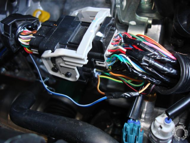

Posted: January 28, 2012 at 4:49 PM / IP Logged
Here is the info from DEI.
Tachometer    pink to RED / White  (AC)      @ ECM, 35 pin plug, pin 22 or cluster
The ECM is behind the glove box.
On the 4 cylinder turbo models, the tach wire is in the 34 pin plug, pin 23.
Can also go to a fuel injector under the hood and use the wire that is NOT blue/black (4 cyl),
red (4 cyl turbo), or yellow/blue (6 cyl).
I usually just go to a F.I., determine the non-common color and tap into it at
the connector pictured below. ( 2010 Forester non-turbo )
alarm/remote start, 06 subaru legacy gt -- posted image.
