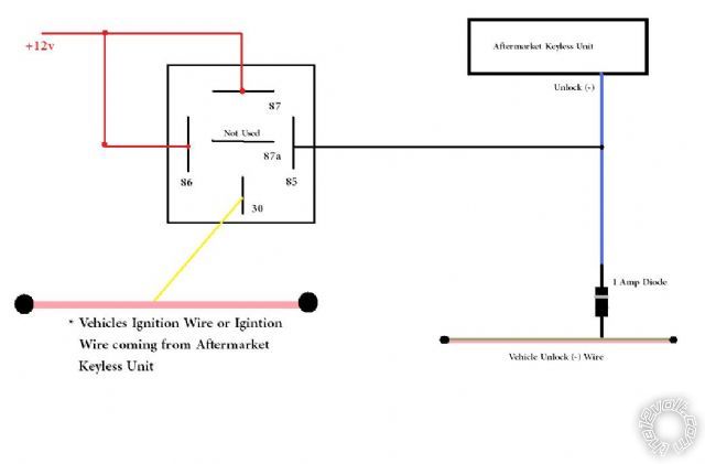

Posted: February 04, 2012 at 7:24 PM / IP Logged
Pulse your ignition wire with unlock. Make sure to diode isolate the unlock wire. Some units have this as a programming option. I do this all the time. This diagram is for negative door locks. Make sure to use a DMM and test your wiring.
