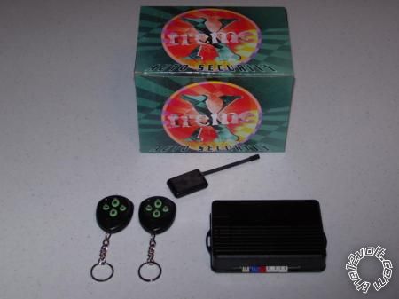

I purchased a remote car starter on ebay, it is an xtreme start xr-22 and I do not have the installation manual for the unit.  Can anyone help me out here by directing me to where I can find installation instructions or by contacting the manufacturer to get them?  Thanks.
The item was purchased here:
http://www./itm/200679672385 Xtreme Start XR 22 -- posted image.

see if this matches your wire colors.
14 AWG WIRES
VIOLET: ....................(+) STARTER OUTPUT
ORANGE: ..................(+) ACC. OUTPUT
YELLOW: ..................(+) IGNITION #1 OUTPUT
BROWN: ....................(+) IGNITION #2 OUTPUT
RED: ..........................(+) 12V INPUT
MAIN WIRE HARNESS
BLUE ..........................(-) HOOD SWITCH INPUT
Connects to Hood Pin (existing or add Hood Switch
ORANGE ....................(-) NEG. WHEN RUNNING
Connects to DATA Module
YELLOW ....................(+) BRAKE LIGHT SWITCH INPUT
GREEN........................(-) NEG. ACTIVATION INPUT (FOR USE AS AN ADD-ON MODULE ONLY)
GRAY ..........................TACH INPUT SIGNAL
VIOLET ......................NOT USED
GRAY / YELLOW..........SPARK PLUG INPUT SIGNAL
wraps around Spark plug wire
BLACK........................(-) GROUND INPUT
Connects to Chassis -
WHITE ........................(+/-) PARKING LIGHT OUTPUT
BROWN ......................NOT USED
WHITE ........................(+/-) PARKING LIGHT INPUT
Connects to 12 Volts + or Red wire on R/S
RED ............................(+) 12V POWER INPUT
