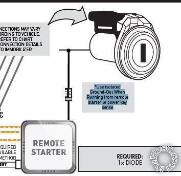

yes your correct using the keysense wire for disarm. You have the blue status output going to keysense through a diode ? Its the diode facing the right direction ? Band toward the remote start system. Have you tested the wire to make sure it outputs a ground when remote started ? Did you test the keysense wire to make sure you had the correct wire ?

2003 sequoia, avital 4103 remote start -- posted image.
i follow diagram above, band of diodes facing remotestarter.
Have I tested the wire make sure it outputs a ground when remotestarted? No, i do not know how to test this.
Test keysense: No, i did not test this eventhough i am sure it is the correct wire.  However, I will do it again.

Do you have a dmm ? If you do take you're red lead and put it on 12v and you're black lead to the suspect wire for key sense there should be no reading on the meter until you insert the key then you should read 12v if you have the correct wire. For testing the status output do the same thing leave you're red lead on 12v and put you're black on the status output of the 4103 you shouldn't read anything until you activate the remote start. Then you should get 12v through out the entire remote start timer
