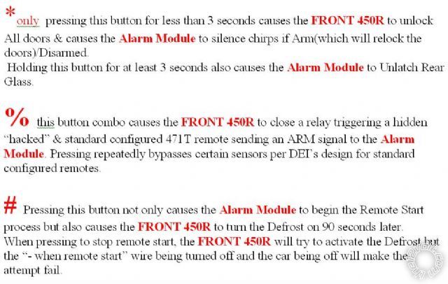

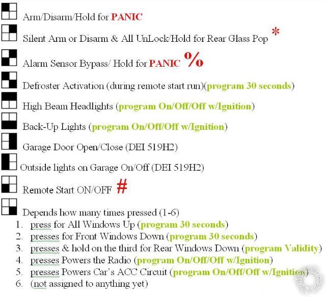

My 1993 Roadmaster wagon is piece by piece getting it's security/start system installed.
Right now it has a viper 550ESP RS/Alarm but I have just discovered that a Sidewinder 6500esp2 can exactly swap into its place and give me the option of smart start capability using a dsm200, dsm250, vsm200 or vsm 250. i have the Sidewinder so i will swap it in soon.
But the huge plus is that i can still use my old remotes that the 450R units in my car and the 519H2 in my garage. i also have a 450T mixed in and other dei components are 2 508D radars and a couple 795W units to give me 6 channels of alarm-pager coverage if i take the pager with me when i leave the car.
i like to think a little outside the normal constraints of owner/install manuals just for the fun of it.
My car also has an anti carjack device that cannot be "undone" with the alarm remote. it cuts fuel and applies the brake plus a few other "naughty" additions. i am disclosing none of its application in this post.
the picture i am going to try to upload breaks the rules of the forum so if it dont load, please be patient as i may have to scramble to chop and/or resize it. it shows how the 4 buttons on my remote can pull off  so many cool things with a simple DEI474 remote in my hand.
So if you do mostly plain vanilla installs and are looking for a few different types of ideas, maybe you will find something to borrow.

BTW... disarming only ulocks the drivers door.
the four button remote are programmed in the "single button " mode.
here is a pic that explains the red notations.
if anyone has questions about any of this, please ask them on the post with a reply and not through private messaging.
its all about having fun and making it work right.
