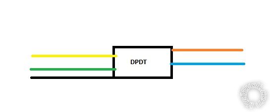

Below is a paint pic I made to show the current function of the DPDT relay:
- Yellow is "accessory" power, i.e. + which is only supplied when the car is on
- Green is constant + power, i.e. always on
- Black is ground
- Brown and Blue are connected to the folding mirror motor and are either + or - depending on which way the mirror is to be folded.
puzzled, dpdt relay and sensing -- posted image.

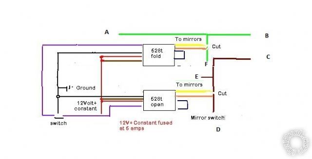

Use this diagram, note the violet wire represents the 528t BLACK/ white trigger wire. I've used as switch to ground both but it you followed the rules and told us what car, as Kevin says, I'm sure we could resolve this via lock or ignition.
Posted: March 15, 2012 at 4:39 AM / IP Logged
Posted: March 15, 2012 at 4:40 AM / IP Logged

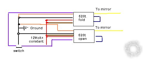

Do you know I think my diagram is WRONG,, I think I can use one each for open and fold!
Posted: March 15, 2012 at 5:00 AM / IP Logged

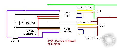

Sorry, I did the original some time ago, newer version!
On fold run it to an ignition wire and diode with a 1N4004, band towards the ignition.
On the 528t used to OPEN the mirrors, from the ignition side of your first join, run a wire to the open 528t BLACK/ white, this time cut the loop on that 528t and diode 1N4004 the other way round, i.e. band away from ignition.
This will give you close on turning off ignition, open on turning on ignition. Set the 528t internal timers for 1 second longer than it takes to open or fold the mirrors.

OK, just so I am clear, looking at the last image you posted the connections are as in the image I posted, I enlarged it and labled each connection. Am also confused as I dont see any switch/accessory power connection, i.e. one which is only hot when the car is turned on.
A: Mirror
B: Mirror
C:?
D:Manual mirror switch
E: ?
F: ?
Posted: March 15, 2012 at 10:25 AM / IP Logged
A + E = driver's door mirror
B + C = passenger's door mirror
D + F = switch
